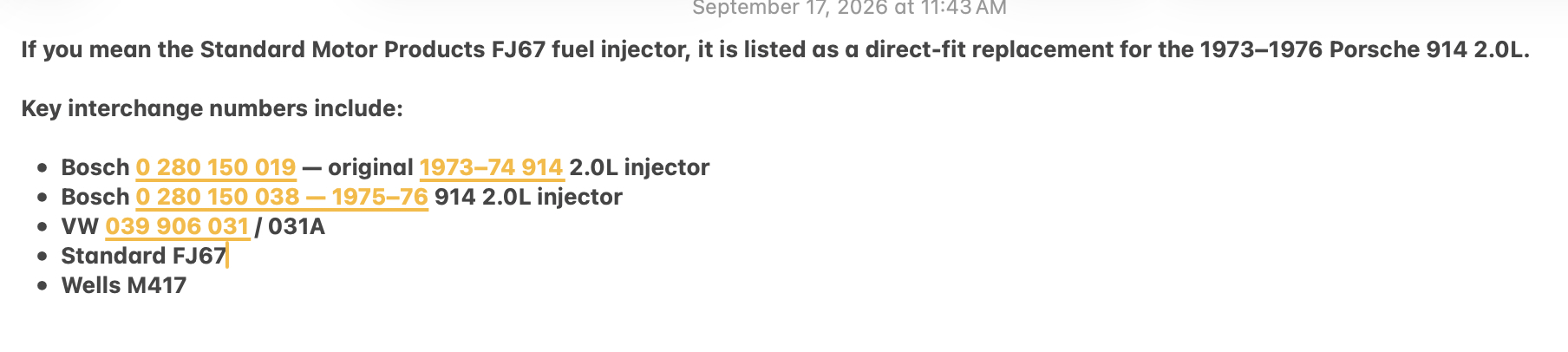

FJ67 Standard Parts Company. Used to be cheap. Now over $100 a piece. Work fine. Mr. Injector has tested these for another member in another post.
I replaced one 4 years ago. Car is happy. About to do the other 3.
FWIW:
ChatGPT
