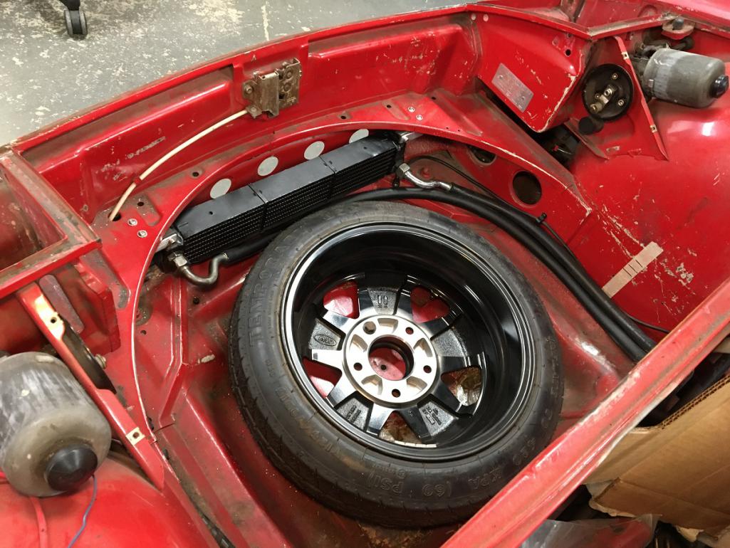

It has a cooler under it, see the pics. Not the correct one though.

That is quite an oil cooler. I went the hole in the body route. I made the hole the same size as the bumper valance hole. So kept it small. I used a really heavy expanded metal and welded it over the body hole I just cut on the inside. Then I made a heavy duty plenum and spot welded it to the body. I really do not think that the car will suffer from the hole I cut. It was not that bad a job, I actually found it kind of fun.

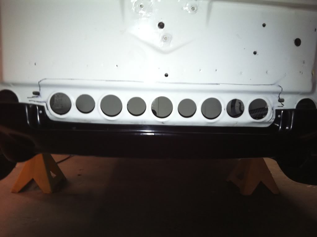

You can mount the cooler behind the front of the car, remove the row of plugs from the front and remover the two round plates on the rear of the trunk floor. They are just held in by seam sealer. No cutting. Use a cooler with a fan pack. You do need to cut out some of the lower front valance.

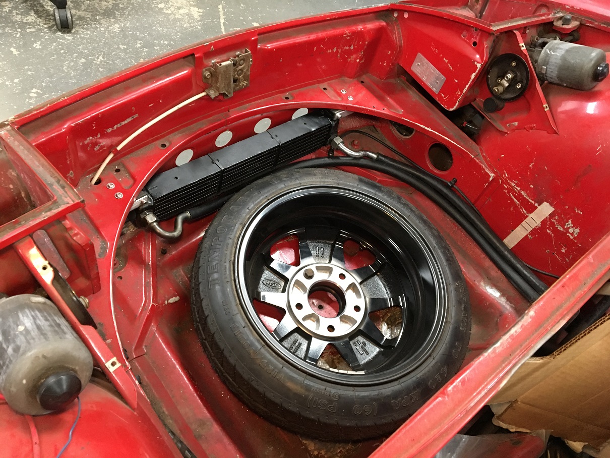

I am currently restoring my 73 and converting it to a 3.2 /6 but staying a narrow body.
I find it interesting your temperature is going up even with that large cooler, but maybe the air isn't flowing out properly in the back of it? Ducting helps a lot too. It looks like you initially had a different cooler?
My plan is to have a Mercedes oil cooler inside the front and remove the 5 rubber plugs as mentioned by Mark Epstein. I am not set on the air exit scheme yet, either the two rear floor stock ports (per Mark) or side wents in the wheel wells.
One thing to consider is the semicircular front reinforcement you have on your car. I like to think Porsche didn't add this for no reason and want to keep it there. Luckily my MBZ cooler fits under it, but is it large enough for the 3.2... (IMG:style_emoticons/default/idea.gif)
As for front, I plan on using the stock bumper and a narrow body GT front valence (FG).
Here was my mock up. The spare is a fake Fuch 15" with a small temporary tire.
Here is the front view.
Again, I don't know if this will suffice as auxiliary cooler for my 3.2. I do plan on running aluminum oil lines along the passenger side long. This should help too.

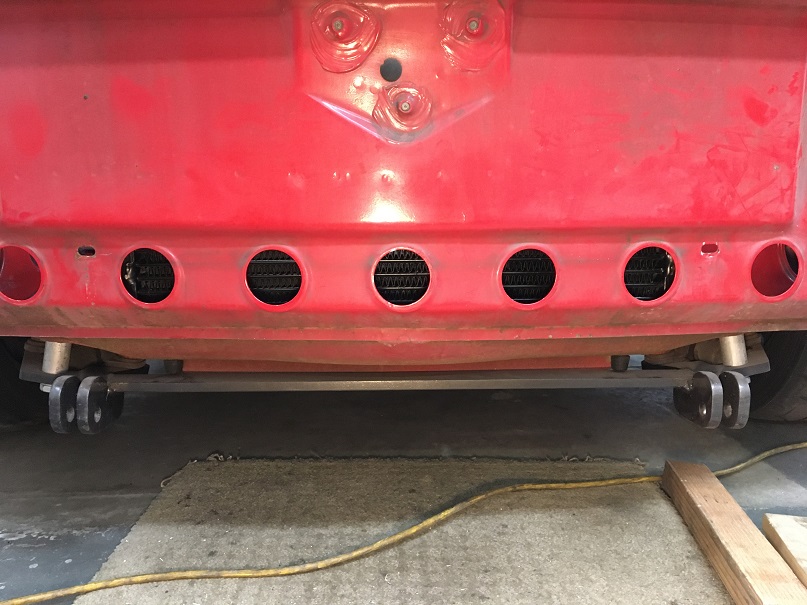

If more air flow is required, adding more holes in between is easy too with a knockout punch like this.
Photo courtesy of 914World

... just noticed the connections to your cooler are on the bottom. You may have a lot of air trapped in there. (IMG:style_emoticons/default/idea.gif)
