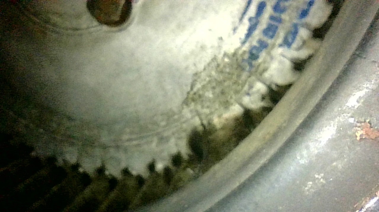

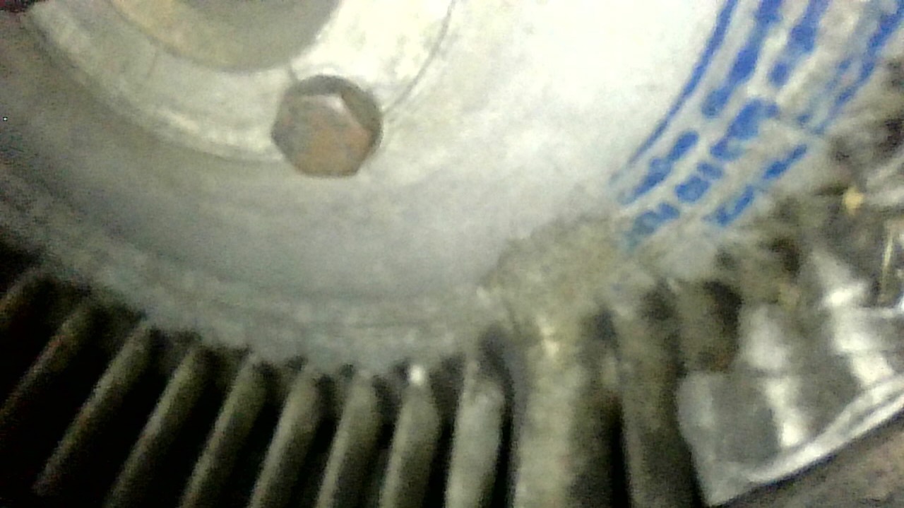

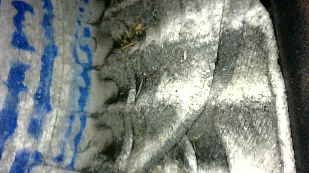

FlacaProductions
post Sep 17 2026, 07:50 AM
Post #18
Posts: 2,283
Joined: 24-November 17
From: LA
Member No.: 21,628
Welp.
We have developments.
I know I said I'm just going to leave well-enough alone, but you know how that goes.
Short story - took the scope and looked at the fan.
I don't think that's supposed to be there.
It's that shop paper towel stuff - like what comes off a roll in a box - heavier than kitchen paper towels. I have two boxes sitting over there so I know it's self-inflicted.
Got it out with a bent hanger and shop vac - but I think I have a bit more cleaning to do in there? With things in place, what's the best way? I'm thinking a very bendable/flexible bottle brush in the front and then maybe thru the timing access hole on top - just turn it over a few times.
I truly wonder how long it's been in there.
I'll say it: it's the basics, folks. I'm just slow. The other "fancy" fixes weren't working but I just kept going down the hard path - which eventually brought me back to the basic path: checking under the tins and in the fan.
I'll take it out for a spin today - low 90's and high humidity so it's pretty much worst-case environment. I'll report back but I feel kinda stupid right now - but also encouraged.
(PS: what's the blue markings?)
Attached Image Attached ImageAttached Image
