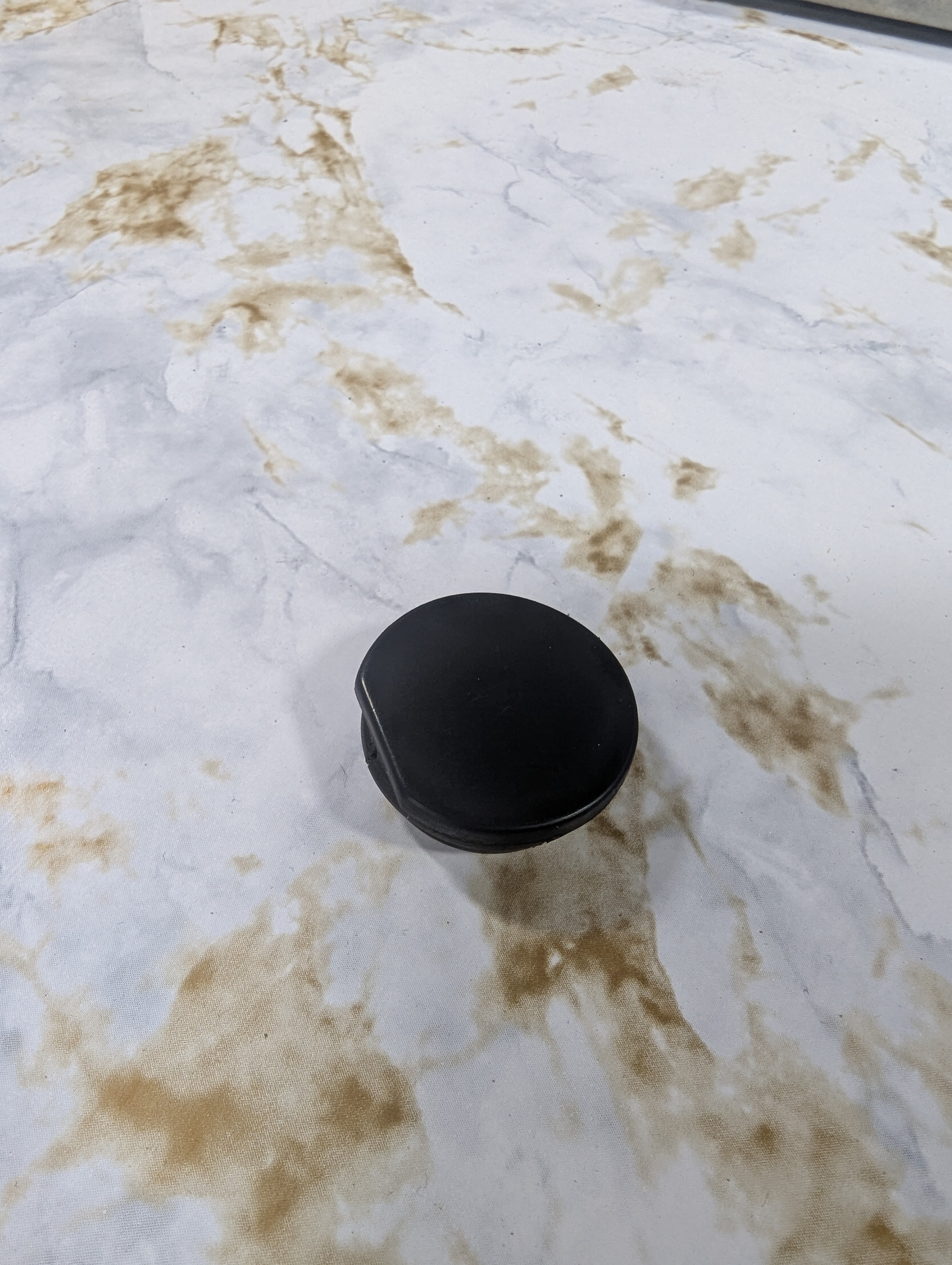

JamesM
I suspect people have found these before and had no idea what they were.
Click to view attachment

914werke
QUOTE(JamesM @ Aug 27 2026, 06:42 AM) *
BINGO!
